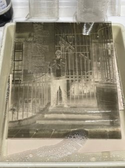

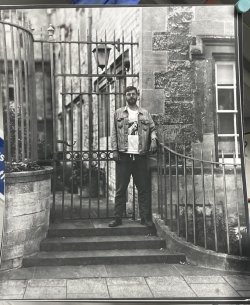

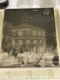

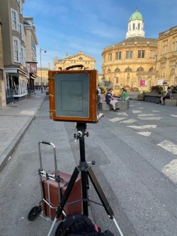

This evening I decided to brave the heat and dragged my 12x10 camera into town to test out my Dallmeyer 15x12 lens for the first time. Having a built in aperture was a huge bonus.
I used Ilford dry plates a friend kindly gifted me. They were found stored in the back of a church.
Rated at ISO 3 and developed in ID-11 1+3 by inspection (23C). Dev time was around 4 mins which was the time I’d previously used at 1+1 dilution at 20C. The darkroom is a bit warm at the moment. The plates are still drying.

Amazing work Nas. Newbie question. The plates look like a negative. John did a portrait of me and showed me the process. When he developed it was a positive. Is this a different process?
My dry plates are designed to be negatives to print from. Sounds like John's portrait of you was an ambrotype which you expose and develop differently. It's still a negative on glass until you put it on a black background at which point it looks positive. The density is different and not designed for printing.

Can I ask what fstop you use and shutter speed. I presume you used a sinar copal shutter?
Oh thanks for explaining. From what your shared, yes it was Ambrotype. That is the wetplate I’m interested in.
I used a lens cap for the shutter. 2 secs f16
