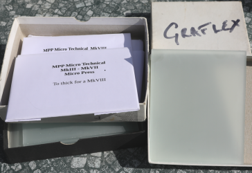

Plenty of Pacemaker screens in the right hand box, 7 or 8 I think,
Wash the fresnel in warm water ans use a sponge, the original Pacemaker fresnels are 2.29mm thick, modern fresnels are typically 1.07mm so you need to use the original, otherwise you would need shimms to fit a new fresnel.

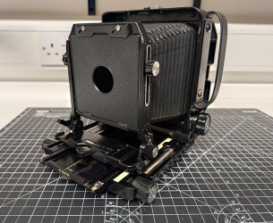

I'm sorely tempted to upgrade, even if funds don't stretch to a Chamonix. The 'Boss' has reluctantly given me the go ahead as well.
Watch this space...
I'm sorely tempted to upgrade...
...and so I did, following a succession of niggling problems with the Speed Graphic; the latest being the sudden ejection/disappearance of the micro screws to one of the strut mounts. Anyway, two 'new' Fujinon lenses are on their way as well, so onwards and upwards...
