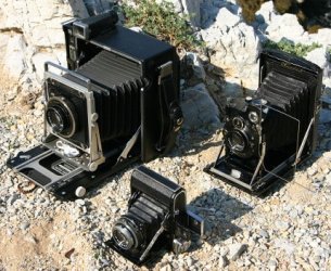

I have both a Crown and a "Baby" Speed Graphic. Both are fully operational with several lenses per format. They do, however, have one problem in common. With time, the internal shutter release cable that transmits the push on the body's shutter release has weakened and will not reliably trigger the shutter. Having to press it hard induces camera shake. Thus, for tripod mounted activity, I use a release connected directly to the shutter housing. For handheld, I just reach for the trip level on the shutter housing directly to manually fire it. (If someone knows how to fix this, I'd be much in your debt.)
The on body shutters were really only useful for the original "standard" lenses like the 127mm or 203mm on the Crown or the 101mm on the Baby Speed that often came with these cameras. These lenses had shutter release tabs that aligned well with the on-body triggering mechanism. Pretty much no other lens I have tried aligns properly with that. In short, I have mostly abandoned the use of the on-body release.
