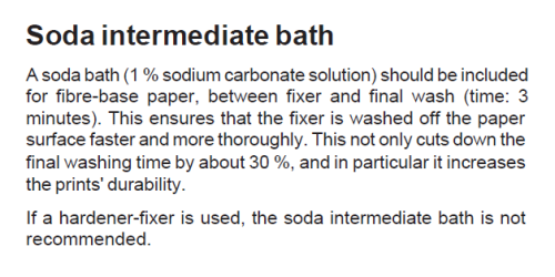

Good tip about the stop bath, yes c41 fix is as near neutral as you are likely to get. I have used fuji hunt c41 fix for pyro developed film. No issues at all. I had the Fuji developer go bad because I kept it in the plastic bottle it came in. Once the seal was broken ir got in. I should have sealed it in a glass bottle. Is the soda bath about 1 tsp per litre or do you need to weigh it out accurately?Wash times for films or RC papers are similar with regular or alkali fixers. There may be a slight difference with FB papers but with a wash aid it's not significant.

This is from the Agfa MCC Technical Data
