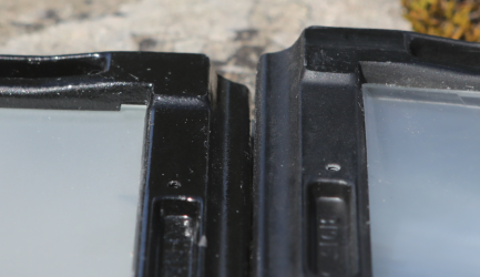

I have just disassembled it and there two panes of glass, the one on the inside has very feint circular image which when viewed from the inside projects kind of a 3D raised dish shaped illusion.The Pacemaker fresnels are quite thick and the rings obvious. The original screens are quite dim, so sounds like a replacement.
The Pacemakers were sold with and without fresnels and the casting is the same, the one for a fresnel is machined to fit the fresnel under the GG.
The one on the left is a plain screen GG holder, note the slight gap which is in each corner, the one on the right has a fresnel and has been machined so the gap is lost.
The one with circles is the fresnel lens. I fitted a fresnel onto one of my Speed Graphic’s and after testing it had to be fitted on top of the ground glass (closest to me) to achieve accurate focus. This is not common and that’s why focus testing is essential.I have just disassembled it and there two panes of glass, the one on the inside has very feint circular image which when viewed from the inside projects kind of a 3D raised dish shaped illusion.
