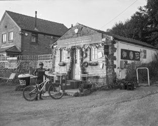

Exposure number eleven
Testing out the Crown Graphic
135 F 4.7 Optar
Fomapan 100 Ei 50 for 1/2 seconds @ F8 in 510 pyro
Happy Days

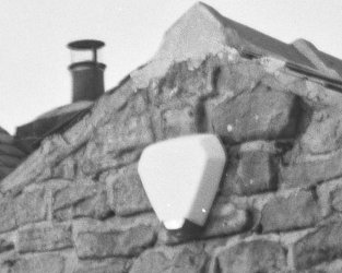

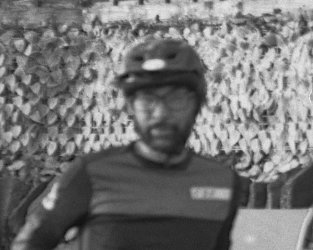

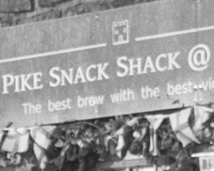

What's wrong here please?
100% Crop
What did you focus on? Did you use a loupe? Could be your ground glass isn’t calibrated to your film plane position but first you need to check whether the spot you focussed on is sharp on the neg. A mate of mine had this issue with his Linhof Master Tecnika ground glass. He tested by focussing on a ruler going away from the camera and had to use strips of film to shim it to the correct position.
I did not use a loupe due to the metal hood being in the way, I focused on the ground glass until I could see the writing above the doors become "crisp". I have looked all over the image at 100% and there isn't a spot anywhere where I could say "that bit is sharper"
I think I can see motion blur there, just pressed the button as cable was in the other camera box.
Ok. I think it’s a combo of shake and lack of critical focus. Loupe and cable release are essential for crisp shots. Either get a long loupe or unclip the hood for critical focus.

The image was taken about 8pm with the sun no higher than 5-10 degrees. the ev of the scene was 9 point something apart from the bright glass and front of the building, I metered off, the very patient guy(James) shirt. I used to mountain bike a fair bit and we had a good chat.
