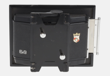

Is the model without the plate worth getting, I assume it is a black one such as the one below, would be good to have two.
the big plate is to fit where the film holder usually sits that back is likely for a different smaller format adapter - small grafloc like a Graflex 23 , usually on a Wista that fits on a sliding back adapter on the metal Wistas.
So no don’t get it as it will not fit
