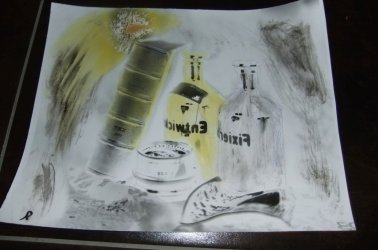

For my paper negatives I love to create masks, then copying neg and print, maybe again - its a creative dodging/burning job, I can bring in details to blank shdow or highlight areas, if using colours or pencils/brushs.
That's an increased 12x16" paper negative with no details in the blank bottles (depending on the orthochromatic behaviour of paper) :
