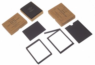

Those four upturned metal tabs would buckle film. They must be for holding something rigid in place.
Glass plate holder. Looks like the wire spring that fits across the slide near the felt trap..is missing. It holds that end of the glass plate in place..You pulled it back..inserted the plate and released the spring....
Got two of these type holders for 1/4 plate somewhere.
The glass plates fit into a slot at the bottom, then there's a sprung clip at the centre of the top. Those tabs push the plate up to the open edges, they negate any variations in plate thickness, which can vary between around 1.4mm to 1.8mm.

Quarter plate & 9x12 film sheaths, two frame like ones are Zeiss Ikon, they might be a problem with the tabs in some holders.
