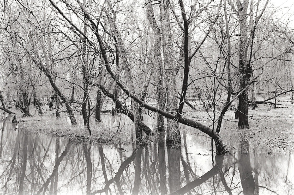

Upon further review, I found an image that better represents the exposure and development practice under consideration here than the prior 'roots' image above does.
This was shot on a larger format (alas 9x6 not 5x4) on a tripod and EMA developed for an hour in Pyrocat-HD 1.5:1:200. The scene here was on a completely grey late winter afternoon and had a very short SBR - perhaps 2 stops.
Note how the development has delivered a very sharp negative with an nicely expanded tonal range and a sort of "lacy" feel to the midtones. Both of these outcomes are courtesy of having 3 separate agitations across 1 hour of standing development.
I can see the mid-tone expansion in this one and it certainly has given it good separation. For an SBR of around 2 Stops, it looks to have achieved some very nice tones
