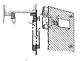

I have a spare bathroom extractor fan so I was thinking of fitting it in my darkroom, but what is puzzling me how do I stop the light from coming through the fan. It will be going through a double brick wall with a self closing flaps panel on the outside.
What have others used to stop the light from coming through the opening.
As Ian said , but I'd recommend having it the other way up, than his illustration shows, so it does trap rain water :)
Thanks Ian I think I can make that on printer..
