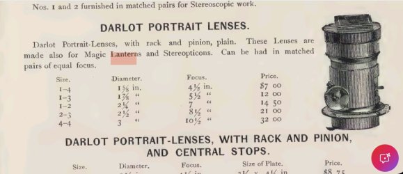

I found an advert for these lenses but I have a question...
The advert clearly states for optical lantern ONLY. However, in the advert from Darlot, they give the impression that their portrait, lantern and Stereopticos are the same.
I understand one is for taking and the other for projecting but...
What, if any, are the optical differences between Lantern and Portrait lenses?
Not a lot, there use, except the Lantern lenses usually have no slot for Waterhouse stops.
I bought this Petzval for £20, some years ago
When J.H. Dallmeyer introduced the Rapid Rectilinear lens in 1866, it killed demand for Petzval lenses, even though they were typically slower.
Dallmeyer had redesigned the Pettzval in 1860, correcting the swirl issue, but they were not as well corrected as the RR lens, so the RR became the dominant design, although Petzvals were still preferred for Portraits.
Most RR lenses were f8, but Petzvals were typically f3 and that difference was important for projection, over 2 stops brighter. Most slide projectors used Petzval lenses
Many companies were left with unsold Petzvals, so sold them off as Projection lenses. These have the slot for Waterhouse slops.
