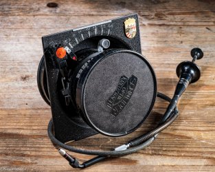

I got my 75mm Super-Angulon for use with my Galvin 2x3, and put it in a 10mm recessed board to gain a bit of bellows extension/flexibility. I did not _need_ the recessed board, but on balance I prefer the extra bellows over the awkwardness to adjusting the controls in the recessed board. It works on the 4x5 Wista DX, though it is a bit wide for my normal interests on that format. Neither of these cameras have a bag bellows option. If they did I would have stuck with a flat board.

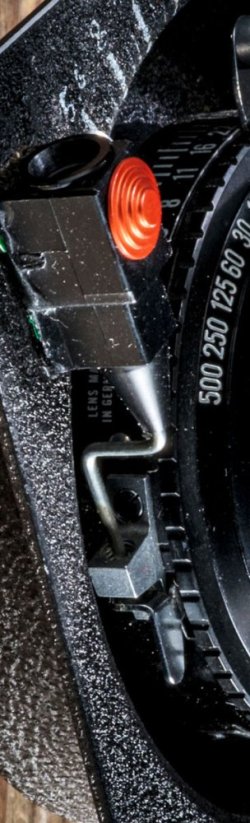

If I am not mistaking, but their lansboard size is the same as the Linhof Technika, then a recessed Technika board might be helpful. Linhof has a special system to operate the shutter when recessed, as then a cable release can't be attached directly on the shutter.
But you will need a special cable release with a typical nipple.
