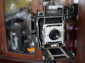

So here it is - mostly in very good condition. The name/serial number plates are missing and the rangefinder is way out of whack, but the shutters both seem to work fine. Bellows are exceptionally clean, and 135mm f4.7 Optar is clean and all it's speeds seem right.
I got a Graflex film holder and an almost full a box of Fomapan 100 with it so quite chuffed.

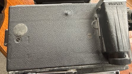

Looks very nice, that would be pre 1955 as that year they had the top mounted rangefinder. Show us the speed settings, the older ones had more speed options.
I might be going mad but I think it might originally have had a top mounted rangefinder ... if you look at the pic there is an indentation on the top leathercloth that looks suspiciously like a rangefinder footprint ... plus some neatly blanked off holes (which look to have been done long ago) .

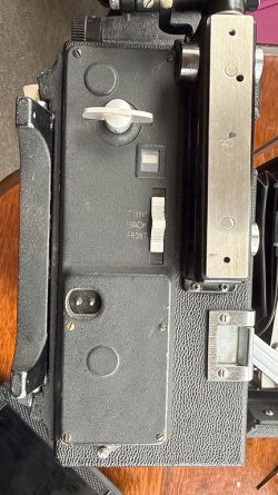

I think the speeds are the 'less speeds' later type.
Ok looks similar to mine so my guess would be early 50s. The earlier ones had a table for the various tension/slit settings.
