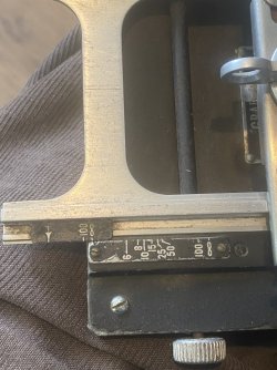

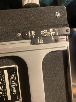

Ok looks similar to mine so my guess would be early 50s. The earlier ones had a table for the various tension/slit settings.
All Pacemaker Speed Graphics have this shutter, as well as the MPP MidroPress.

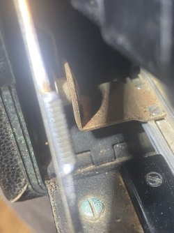

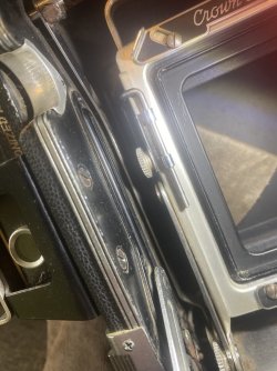

Yep ... that was on the radar: it has a fresnel on the film plane side of the GG so I will be checking that
Pacemaker Crown & Speed Graphics were sold with and without a Fresnel. The focus screen frames differ, to allow for the Fresnel under the Ground glass the T distance is 3.6mm. It doesn't help that the casting numbers are the same, the frame for no Fresnel has a T distance of 5.00mm The ISO standard is 5.00mm +/_0.178mm
Very early MPP film holders, and older wooden 4x5 film are 0.2 inch register, however as that is 5.08mm they are actually within tolerance.
If the Graflex focus frame is 5mm then you need to add the Fresnel on top of the glass screen, and shim the clips that hold the ficus hood.
