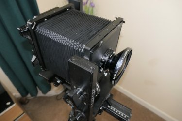

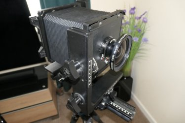

Here's my Sinar Norma with 90mm f5.6 Schneider and wista 6x9 roll film back

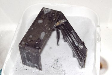

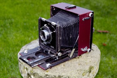

Back in 2018/19 I bought two MPP MkIII MicroTechnical cameras for £70, one was just parts,. This one had badly worn covering so I removed the back and front standard, leaving the bellows attached to them. Then soaked the casing etc to remove the covering. I also cleaned the track bed.
When dry I re-covered the body, I had found a rear focus screen hood at a camera fair and used the same leatherette. I then lubricated the focus track bed, then reassembled the camera,

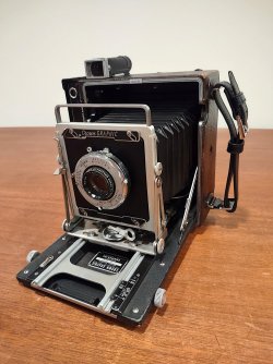

I normally shoot 5x4 with a Wisner Technical field camera with the usual assortment of lenses. Some years ago, I acquired a quite well used Crown Graphic as a more portable option when I don't need/want the weight and girth of a the full Wisner kit. 5x4 Graphics were long ago my entre' into large format, so I had some idea of what I was getting into.
This camera appears to have been an old workhorse studio shooter, insofar as it had a metal studio logo badge nailed into the top of it. I gave it a good scrubbing (though not at @Ian Grant levels), cleaned and lubricated the rack and pinion, disassembled and cleaned the ground glass assembly, and put a light coat of wax on the camera exterior.
Then, I ran the slightest bit of naphtha into the gear train of the 127mm f/4.7 Ektar that came with it. Well ... sort of. It's my Franken-Ektar as I took the front element from this lens and the back from another as the back element was a bit dodgy. After the naptha treatment, the shutter speeds were pretty much spot on.
This morphed into "I need more lenses" and today I also have a 65mm f/5.6 Super Angulon, and an 8 1/2" f/6.3 Commercial Ektar mounted in Graflex boards. More recently, I added a new lens board and a 207mm f/7.7 Ektar (pictured here) to it, and a brand new aftermarket strap. Both the 8 1/2" and 207mm lenses underwent CLA last summer so they're good for many years to come.
This camera has richly fulfilled my expectation of being a lighter, faster to use 5x4 than my field camera. So much so, I keep contemplating reversing the front standard to get easy front tilt which is all I really miss from the field camera. This has the effect of losing rangefinder calibration, but I pretty much never use that anway.

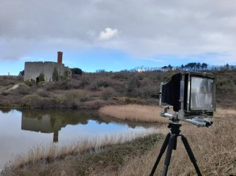

A Norma on a short rail with bag bellows makes a great field camera.

Sorry, delayed reaction...
The Norma on a 6" rail with bag bellows is 3.4kg.

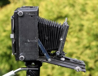

8x10 Norma
