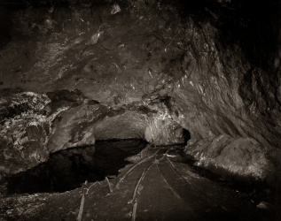

I remember making this shot in the 1990s underground in a Manganese mine in North Wales.
We had torches and 4 hammerhead flash units. I had pre-focused my Wista & 65mm SA in daylight, and was shooting at f16 or f22.
For his image the area was painted with the 4 flash units, all set at full power, multiple flashes from each, I heard the others close their shutters way to early. I was the only person to get an image.
Somewhere I have a table for the extra exposure needed with multiple plash exposures, it was referring to multiple flash exposures to allow LF lenses to be stopped down mire in studio work. I remember it recommend 5 flashes when the calculation would be 4. it's exactly the sane with multiple daylight exposures.
